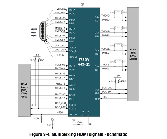

Do you think it would be ok to have, with either an HDMI or DVI connector on the one side an HDMI and a DVI connector on channels A and B of the other side ? Apart from properly routing the different channels on both connectors would I then to have a different hot plug detect configuration for both HDMI and DVI connectors if connecting them to screens directly ?
