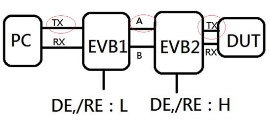

Hi Team,
the current test is to use Ti SN65HVD7x EVB *2 and change THVD1429 sample ( only switch DE/ RE, determine the direction), transmit command.

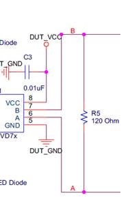

the DUT (STB) on the schematic diagram is connected to the Debug port, the schematic diagram is shown below, the A and B signals of EVM only measure the 3.3v voltage level, no DIFF signal.
may we know is there connection correct? and the DE/RE signals setting correct? thanks.
the terminal resistance of EVM is 120ohm, see the figure below:
