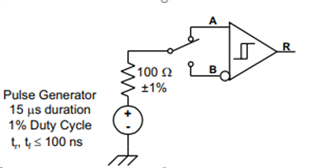

For SN65HVD888, we can see that there is a transient test in abs max parameters, as the figure below:
How about the detail of transient waveform? How long can it last?

Hi Shaofeng,
The voltage input, transient pulse, A and B, through 100 Ohms is specified with the following setup:
So this spec is 150ns pulse with rise/fall times less then or equal 100ns every 15us.
So not very long pulses are really supported by the standard.
