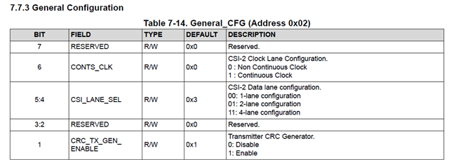

Hi
My ISP outputs MIPI CSI-2 Continuous Clock mode to Serializer,
Is it necessary to configure the register 0x2[6] = 1?
It seems it works well with the register 0x2[6] = 0.
Thanks for your help.
