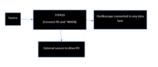

    When using manual configuration of the TFP410, I2C/RST low, can the design be configured to disable the T.M.D.S transmitters when no monitor is connected and re-enable with the monitor is connected?
    Example:
    • I2C/RST Low (using external configuration pins)
    • MSEN/PO1 pin tied to /PD pin.
    • The MSEN/PO1 pin will be High when a monitor is detected and Low when a monitor is not detected.
    • The /PD pin places the chip in power down mode Digital I/O buffers remain active.
    • In the example above, when /PD is low, will the MSEN/PO1 monitor detection circuitry function and drive MSEN/PO1 pin accordingly?

  • The best way to see if you can use the hot plug to power down/ on the device would be use a test setup like the following block diagram.
    Keep in mind that MSEN is pulled low when a monitor is detected and high when a monitor is not detected. This means that you will need to invert the signal between PD and MSEN as when PD is low the device will be in power down mode. If a signal is seen on the scope when MSEN is low, then you can move forward with testing with the proper display.
