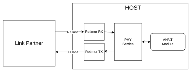

Hi TI experts,
According to this table it states that DS280DF810 does not support link training. I need few more clarification on the description. Does it mean that the coefficient update training frames from the link partner will never be received by the host in the following setup?
Secondly, Is there any possibility for the signal to pass through the retimer without applying the TX FIR settings? Moreover is there a procedure to pass the signal through the retimer without retimer manipulating the signal?
Does these sequence have any effect?

  • Hi Mohamed,
    The retimer is not protocol aware, so it would not distinguish between actual data and link training data.  I expect that link training frames can pass through the retimer, but the training pattern will not have any of the pre/post adjustments set by the host/link partner since it has a non-linear signal chain.  Because of this, link training is not supported.
    When the retimer is in "RAW" mode, TX FIR settings are not applied.  However, the signal chain through the device does not have the linearity that DS280BR820, DS280MB810 have.  Because of this, we would not recommend using link training with DS280DF810.
    Often, hosts have an option to disable link training.  I would recommend disabling link training with DS280DF810.
