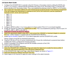

In DS320PR1601RSCEVM user manual it is specified that no shunts are placed on JMP22.(image of same given below)
Does it mean none of the PRSNT 2 signals are connected to PRSNT_1 signal?
Is PRSNT_2 signal indicates the link width?
