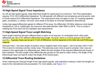

Hello, I have encountered some issues with the SN75LVPE5412.
May I inquire if there are Layout Guidelines specifically regarding the length of TX and RX lines?
In the scenario where I am using Pin Mode, and there are no speed issues with Port A, but abnormalities occur when switching to Port B, how should I make adjustments?
In the situation described in question 2, are there any specific requirements for the lengths of TX and RX lines?
