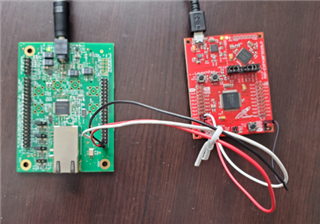

I am in the process of programming the Registers in DP83867IRPAP-EVM using MSP430F5529LP Launch PAD through USB-2-MDIO.
The following steps are done.
1. Followed through USB-2-MDIO Software Tool (ti.com)
2. Did Flash the MSP430F5529LP Launch pad using Uniflash with 7357.msp430-usb-to-mdio-universal-v3.04.txt   => Success.
3. Powered and Connected the PINs 4.1 (MDC) and 4.2 (MDIO) of the  MSP430F5529LP to the respective PINs ( MDIO : 37 and MDC : 39)  of  DP83867IRPAP-EVM.

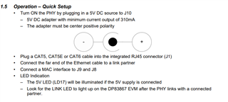

4. When Register Read/Write is initiated through USB-2-MDIO, It says "Device not Connected" as shown below.
Please let me know what is missing in this setup and how do we fix this "Device Not Connected" ?
