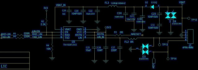

Hi team,
My customer is evaluating TLIN10283DRQ1 in their project. Below is their schematic, could you please help review and give some comments?
Thanks!
Ivy
  • Hi team,
    Do you have any comments? Thank you!
    Ivy
  • Hi Ivy,
    Sorry for the delay.
    This schematic looks good. I only have a few questions that may lead to a small change. See my notes below.
    • Decoupling capacitors on Vsup and Vcc.
      • 100nF capacitor is recommended on Vsup input (C20? or C29?).
      • Vsup filter circuit looks good otherwise.
    • 220pF on LIN bus with no external pull-up is appropriate for responder node - no issue.
    • ESD protection on LIN and Vsup lines with ESD2CAN is appropropriate.
      • Consider ESD1LIN if smaller form factor 1-channel ESD is desired.
    • Series and biasing  resistors on digital lines look good - no issue.
