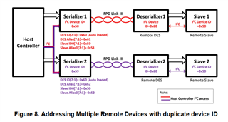

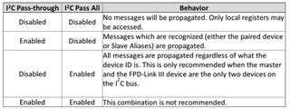

I have project using chip FPDLinkIII ds90ub947-q1 and ds90ub948-q1. I referenced https://www.ti.com/lit/an/snla222/snla222.pdf about using I2C Pass Through or I2C Pass Through All function. I want to use I2C Pass Through function of ds90ub947-q1. I find in datasheet ds90ub947-q1.pdf and see DES ID register but I can not find any register to write DES Alias ID. Please help me how to configure it and descript to me about differential of I2C Pass Through vs I2C Pass Through All. Thanks very much!!!
