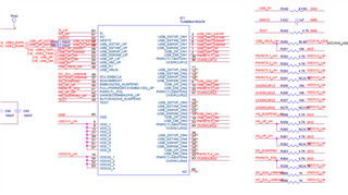

TUSB8041: it could recognize the upstream device but the downstream device couldn't
Part Number: TUSB8041
 One customer used TUSB8041 for his application, but it could recognize the downstream device, the power up sequence is as following:

  • Hi Kailyn:
        First please remove R363 on SMBUS/SS_suspend and try again.
       2: how do you get Vbus for downstream port?
        3: Can you send full schematic for review?
    Brian

  • Hi Kailyn:
        Can customer check if vbus for doswnstream ports is on (5v).?
        Did they try to remove R363 on SMBUS/SS_suspend?
    Brian

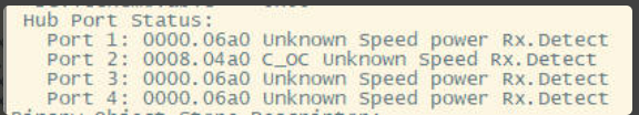

  • Hi Brian,
    Thank you very much for your reply. According to the customer feedback:
    1: Remove R363
    2. After Soc uboot, then TUSB8041 power up again.
    He found that some boards are recognized, but some could recognize one of the downstream port ,while some could recognize two ports, the logs are different:
    Recognized: Port 1: 0000.06a0 Unknown Speed power Rx.Detect
    Unrecognized: Port 2: 0008.04a0 C_OC Unknown Speed Rx.Detect
    The detailed logs are as following:

    Hub Port Status:
    Port 3: 0000.06a0 Unknown Speed power Rx.Detect
    Port 4: 0000.06a0 Unknown Speed power Rx.Detect

    Hub Port Status:
    Port 1: 0000.0503 highspeed power enable connect
    Device Status: 0x0001
    Self Powered
    Best regards
    Kailyn
  • Hi Kailyn:
        it looks hub TUSB8041 is recognized by host as 4 ports hub.
        What device were connected to downstream ports ? did they see VBus is on form downstream port?
        Maybe we can have a call to speed up debug.
    Brian
  • Hi Brian,
    The problem has resolved due to the U port has overcurrent.
    Best regards
    Kailyn
