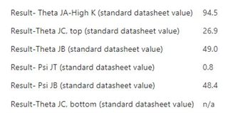

    Can you also provide the junction-to-case thermal resistance?
    I've tried looking this up in our internal thermal system but it seems to be bugged for me at the moment. I'm going to leave this ticket/thread open and check back tomorrow to see if it works for me. If not, I will submit a new request to get this information (usually this takes up to 2 weeks though so I'm hoping I can search the database rather than submit a request).
    -Bobby
  • Harrison,
    I've confirmed with my colleagues on the thermal database. Looks like it's not in it so we will need to submit a request. I've already put in a ticket for it.
    I'll keep this thread open and report back when I get the thermal data.
    -Bobby
  • Hi Harrison,
    Apologies for the wait. Below are the thermal parameters that we've been waiting on.
    -Bobby
