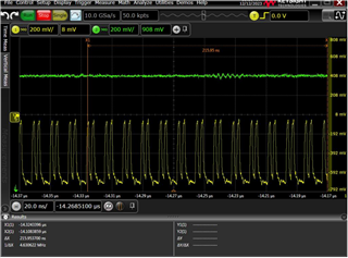

Problem phenomenon:

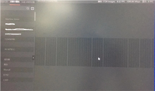

Symptom: In Full mode (clock frequency 85Mhz), the display appears vertical stripes (the content displayed is the content captured by the camera).
Waveform capture: DS90UB928QSQX is found when problems occur, channels X0, X1, X3 high-speed undecoded data out, data packet loss, only X2 decoded data out;
Temporary solution: the problem does not recur after replacing the IC with 421/422;
Requirements: How to locate and resolve the packet loss problem?

In case of vertical stripes (yellow line is 927 input, green line is 928 output)
  • Hi Will,
    Is there a photo of the vertical stripes you can show?

    below is the pic, please refer:
