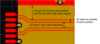

For RJ45 with built-in pulse transformer,
How should I place the GND plane for differential signals?
Please let me know if there is a recommended layout.
If the GND plane is placed close to the differential signal pins of the RJ45,
the GND plane will be strongly affected by electrostatic discharge.
On the other hand, if the GND plane is placed outside the RJ45, it will affect impedance control.
Which should I prioritize?
