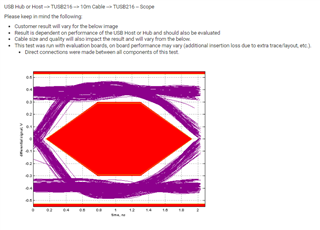

I would like to extend USB 2.0 signals at around 10 meters.
Is it possible to use TUSB216 ?

    It would be possible to do this, yes. Please view the below picture for our recommendations:
    Additionally, We recommend using one of our newer redrivers, such as the TUSB216I, the TUSB217A, or the TUSB211A.

    According to the eye diagram following, what was BOOST Level, RX_SEN Level and power supply parameter ?
    The settings used in this example were not tracked, however, each system can have its own unique properties for drive strength, cable quality, or other factors like connectors, so the best way to approach determining what settings are best is to start at the lowest settings, BOOST 0 and RX_SEN Low, and working up from there until you see a satisfactory eye diagram.
    The power supply for the redriver was likely pulled from VBUS of the incoming signal, which is 5V, however, voltage for power should not have an effect on the amount of boost provided by the redriver.

    I will try to set BOOST en RX_SEN on my proto board.
