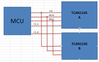

Hi team,
The customer proposed the following solution, please help to see if it is feasible?
I feel it is similar to this description.

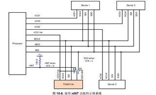

Hi team,
Hi Eric,
one more question:
When CS_A is enabled and CS_B is disabled, what is the status of MISO, MOSI, and MCLK of CAN B? Is it low level or high impedance? Will it affect the normal communication of CAN A SPI?
