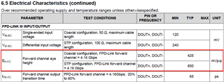

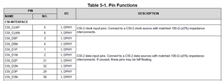

  • Hello Raneel,
    the forward channel eye diagram height can be found in the datasheet.
    Also, there you can find the requirements for the incoming CSI-2 signal for AC and DC, HS and LP states.

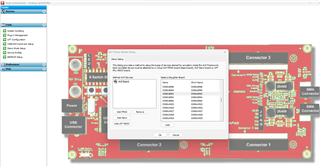

  • Hello Hamzeh Jaradat,
    I am  trying to do Link margin analysis of component DS90UB953 we don't have de serializer and we have installed ANALOG LAUNCH PAD,
    I need support for the simulation, Can you please guide me for this with specific document or related video content.
    or else I can share our PCB data to do analysis if you can help us.
    we are expecting  your support with this link margin analysis.
    Raneel
    PH: +918074662327
  • Hello Raneel,
    Margin Analysis can only be run on a DES paired with a SER. This is to test the quality of the link between both devices and show how much margin you do have in your link. Unfortunately, there is no way to run this analysis on the SER only.
    Just to clarify, are you trying to simulate the PCB using a 3D or 2.5D simulator for checking the signal Integrity performance of your board's design? If this is the case, then this is something we can't help you with. You may need to consult the Simulations software vendor for that.
