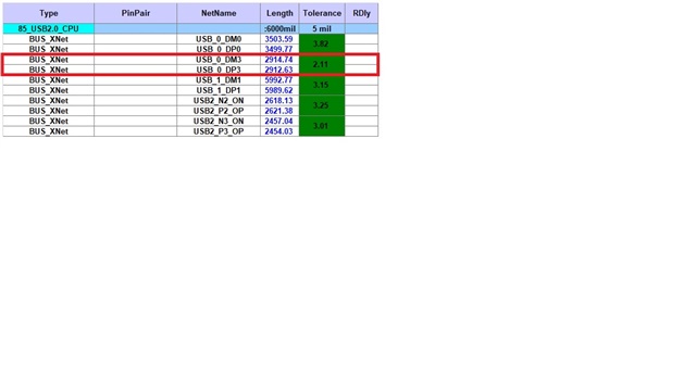

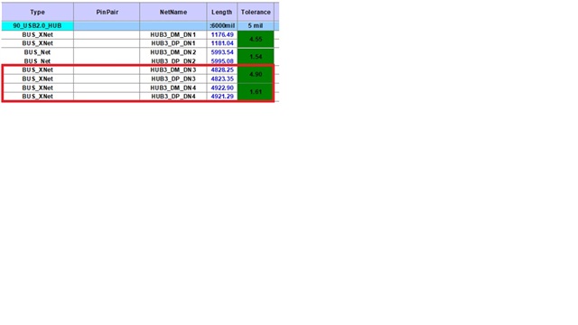

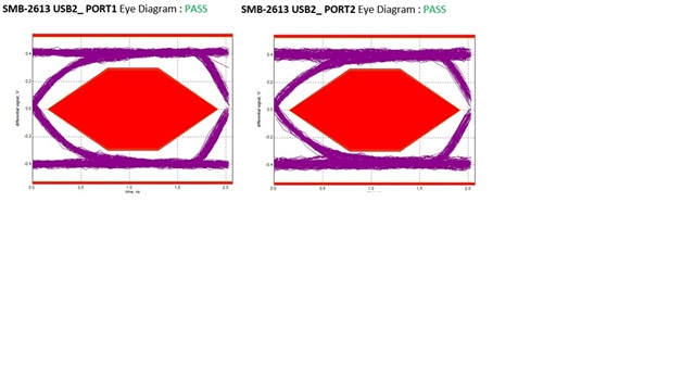

It failed on upstream port right. Currently, there is no problem with the SoC native port verification eye pattern.

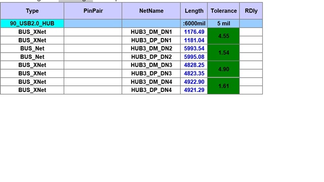

There should be no problem with the SoC to HUB section. The following is the SoC to HUB trace length table.
What is trace length for DP_UP and DM_UP?

Normally if DP/DM trace length is over 4ch, USB2 HS eye diagram may not pass.
Is hub upstream port connected to SOC with trace only or with cable? I just wonder why need to test hub upstream port HS eye diagram if it is not connected to USB connector.
