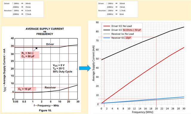

    My customer compared Figure 5-2 and Figure 10 in the previous datasheet.
    The receiver-side current looks smaller, but the driver current looks larger.
    At 1MHz, the receiver current reduced by ~3mA but the driver current increased by ~16mA.
    So the total current increased by ~13mA.
    It looks like power dissipation is increased. Is this correct?
    Also, could you elaborate on why you mentioned that the Figure5-2 includes ICC + IOUT + I_AC_Loss (some power current is lost due to output frequency)?
    I think ICC includes IOUT + I_AC_Loss.
    Kazuki Itoh
  • The driver current includes the current that flows over the bus and through the termination resistors. The new driver generates a voltage drop of about 2.65 V over the termination (which is more than the old driver, so the current is higher); to compute the power dissipation in the chip itself, you have to subtract that.
    Figure 5-2 shows the current that flows into VCC and out of GND. This includes the current that the driver consumes itself (both when idle, and the frequency-dependent current to (dis)charge the MOSFET gates), and the load current. ICC is usually defined to be the total current, but in this case, it's the idle current with not load.

    Clemens is 100% correct in his analysis - but I will summarize quickly.
    1. The average VOD is going to be outputting higher than the old device due to the new die - which means more average current during operation to keep that higher typical output voltage. That will lead to more current from VCC - so there could be a larger power consumption. The ICC in the electrical specs is specifically unloaded current  - that is generally where you will see the most improvement in power - i.e. when the bus is unloaded and idle. You need at least to be able to provide ~28mA of current to hit basic RS-485 1.5V spec across 54 ohms and there is very little margin above that on old device. Essentially the difference is due to the drive strength typically being stronger on new material.
    2. Figure 5-2 I mentioned multiple losses because of how we specify ICC. ICC at a high level is current flowing into the VCC pin - however the ICC that we report in the datasheet is basically measuring ICC(q) or the quiescent supply current of the device when it is unloaded - basically what is the current this device is going to consume regardless of loading - as this current is pure loss it isn't  providing a signal to a load - this is the base current is going to be present in every ICC measurement.
    However when you load the output ICC is going to increase from what is reported in datasheet because the output is now loaded. At this time if you measure the ICC current during operation the current measured is basically a combination of three things:
    ICC = ICC(idle; no load) + I_OUT (Current driving load - which is termination resistor) + I_LOSS_AC (there is a frequency component - higher frequency signals will cause more AC switching losses through driver - i.e. why the X-axis is based on frequency)
    ICC(idle; no load) + IOUT will remain pretty constant in the same operation environment regardless of frequency - but AC losses will vary with data-rate.
    I will be as transparent as I can - these are 1 IC tests - we sweep across 1IC they are not statistically significant graphs. I.e. customer will have to do testing themselves in their system because while our guidelines that I have provided above should give a good idea on what changes they may expect they need to confirm in their old systems and they aren't going to an extremely detailed analysis of every finite point- basically what I have given is what I can give you.
    Parker Dodson

    I understand that the I_OUT increased due to the better driver strength.
    Has ICC(idle; no load) and I_LOSS_AC decreased by the PCN?

    1) I_LOSS_AC is not something we directly specify - so we don't have a number. Figure 5-2 includes it in its typical graph to give an idea of how frequency relates to ICC.
    2) yes the typical most likely has decreased as I have already said - we don't give a minimum and system needs to be designed with respect to max possible condition. It feels as you keep fishing for us to give you a number that I am not going to give you. All the information about the PCN has already been given - they need to do their own test and qualification if there is concern.

    Also it was a bit hard to me to have the customer interpret the difference between old Figure 10 and new Figure 5-2.
