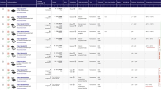

Good morning,
on an IEE1394 board used on our systems, we use a component that are considered obsolete and out of stock: TSB41BA3BPPFG4
I'm looking for an alternative to be able to purchase a quantity of 1200 units, to stock up and be able to bring my board to the end of its life.
I'm opening the DIGIKEY distributor, but I notice that many different codes are available, which I can't even find in the data sheet. These are
TSB41BA3 IPFP qty 145
TSB41BA3 BPFP qty 472
TSB41BA3 BTPFPEP qty 96+8
TSB41BA3 ATPFPEP qty 86
TSB41BA3 DIPFP qty 77
TSB41BA3 APFP qty 0+2105
TSB41BA3 PFP qty 2734
TSB41BA3 AIPFP qty 0+4708
Since I can't find an explanation of what these code extensions are, could someone help me understand what is best to buy?
Any suggestion for direct purchasing?
https://www.digikey.it/it/products/filter/interfaccia/driver-ricevitori-transceiver/710?s=N4IgTCBcDaICoGUBCAWAjEgggZhAXQF8g
  • Ignore the G4 suffix.
    A/B/D indicate newer revisions. You should get the newest revision (TSB41BA3D), if possible.
    I/T indicates temperature ranges.
    PFP is the package name.
    EP indicates "enhanced products" for military or aerospace applications.
    You could get devices directly from TI; the LTB date is May 9th.
