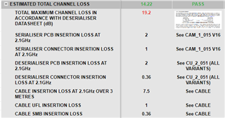

  • Hi Justin,
    The stackup is a FR408HR design with a DK of 3.7. I'm using a 6-layer design as follows:
    My areas for concern are as follows:
    1. I have SMB connectors on the edge of the design. I can't get any information from the supplier that tells me how I should route to this connector to make sure 50R impedance is maintained. The connector is a CONSMB003.062-G, 50R impedance, rated to 6GHz with a insertion loss of 0.36dB at 2.4GHz (close to 2.1GHz). The concern here is "What is best practice for this connector to maintain 50R impedance?". Should I put a keepout on L2 under the pad of this connector (except for the trace itself) to ensure the trace width is maintained as close to 50R as possible?
    2. I can't accurately take all the channel requirement parameters as listed in the datasheet however, I've done my best at estimating the total channel requirements from datasheets (which I appreciate isn't the best way of doing this and needs verifying with a VNA when these PCBs arrive). Again, the "concern" here is will the proposed stackup shown give us "the best chance" at getting a low return loss?
    Thanks again for your help.
    Kind regards,
    Connor
  • Hello Connor,
    It seems you are using an RG-178 flexible coaxial cable and an SMB connector in your design. If this is a test board, then that's fine. But typically, customers use automotive grade connectors for improved mechanical strength and reduce EMI/EMC.
    For this specific type of surface-mount SMB connector, I believe the default footprint listed in the datasheet is fine. The only issue I would see is if excess solder is added to the data pin.
    For impedance, if your PCB layer thickness is optimized such that the width of the PCB trace is the same width as the data pin landing pad of the SMB connector while achieving 50-Ohms impedance, then you don't need to add an anti-pad. If the SMB connector SMB landing pad is thicker than the PCB trace coming into it, then you may have to evaluate if it is necessary to add an anti-pad, using a calculator tool like Saturn. Depending on the calculation, you can choose to add or not add an anti-pad depending on which option better maintains 50-Ohms impedance through the connector.

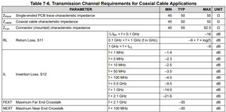

    For the Channel Requirements, the Total Channel Requirements are defined here:
    There is no specific requirement for the IL/RL across the PCB traces or cable. As long as you meet the Total Channel Requirements across two PCBs and a cable (under high temperature and current load conditions), then our SER/DES devices will work as intended.
    The PCB stackup is only a means to meet our Layout Guidelines. As long as you have a stack-up that allows you to route the high-speed FPD-Link traces over a continuous GND plane, maintain 50-Ohms (+/-10%) single-ended impedance all the way from the SER device to the DES device, don't route any noisy signals near the high-speed signal (S>3W), and try to keep the PCB traces as short as possible (to minimize Insertion Loss), choose a cable with decent loss characteristics, choose a dielectric material with decent loss characteristics, then you have the best chance of meeting our Total Channel Requirements.
    If you can't route your high-speed traces to follow these guidelines with your current stack-up, then you may need to add more layers or increase the dimensions of your board.
    IL/RL on the high-speed line also heavily depends on the layout. After performing layout, the only way to get more confirmation on the IL/RL characteristics is to either run a simulation with a software tool like ANSYS, or take physical measurements.
