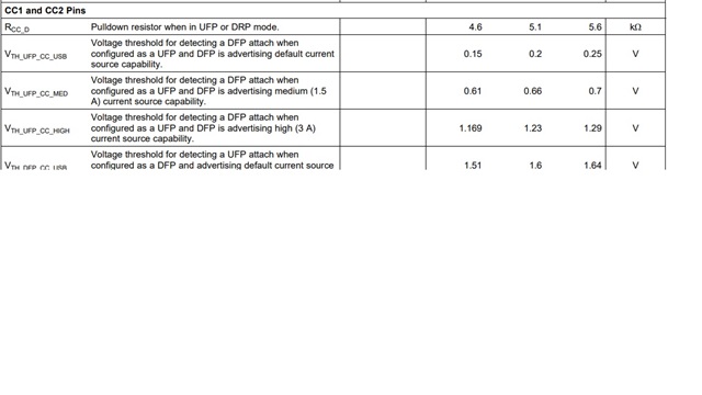

The customer would like to ask the following
Does this mean it supports dead battery mode?
Hi Gareth,
The TUSB321 supports dead battery mode. You can use the TUSB321AI datasheet as a reference for dead battery mode characteristics.
