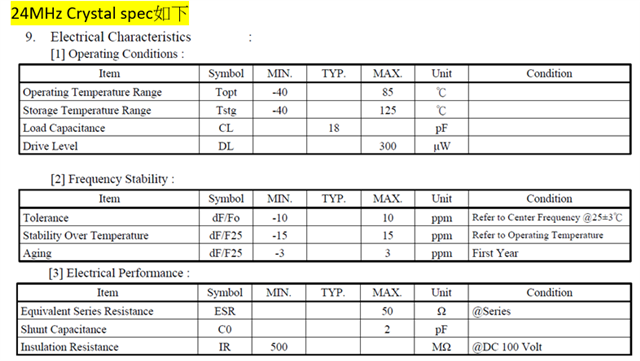

  • Hi Zoe,
    Please see below.
    As I know our 936 need to output XO to let crystal generate the corresponding CLK into 936 XI pin. But for this suspected 936, there is no signal from 936 to let crystal work.
    We also removed the crystal to measure the Xo pin waveform between ok's 936 and suspected 936.
    ok's 936 XO = 0.9V
    suspected 936 XO = 2V
    Roy
  • Hi Roy,
    In the initial post it was stated "The crystal spec driving level requirement is 0.01uW." and the frequency was 26MHz however, the pictured specification has a maximum drive level of 300uW for a 24MHz oscillator. Is this the same part experiencing the issues?

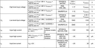

    When using a crystal oscillator we support using a 25MHz crystal oscillator.
    The clock source must also meet the voltage and current specifications listed below at the pin.
