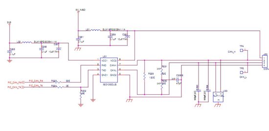

  • Hi Thomas,
    Thanks for such a quick reply.
    I have taken the reference of the ISO1050 eval board schematic.
    I attaching my schematic.
    I suppose now I should not have the 60 ohm termination in my schematic and usual 120 ohm differential is sufficint or 60 ohms split.
    Pls let me know if any mistakes you have found in that.7723.ISO CAN.pdf

  • Chaitanya,
    1) RS-422 is similar but not equally terminated to RS-485. The difference is that RS-485 is a multi-point bus, which means every node can transmit and receive. However, only one driver can be active at a time. So if one node starts transmitting (or driving the bus) all other nodes must be in receive mode. Ther termination is a 120 ohms at both bus ends.
    RS-422 is a multi-drop bus, which means that at all times there is only one dedicated driver (typically located at one end of the bus, while the other nodes are always receivers. Ther termination is a 100 ohm resistor at the one bus end opposite of the driver.
    CAN is similar to RS-485 in the way that every node can tramist and receive. Therefore 120 ohms termination is required at both bus ends. Some designers have termination on each node. This termination however must be made selectable via jumpers. And in your user manual to the customer, there must be an instruction included saying ONLY THE LAST TRANSCEIVER AT EACH BUS END CAN HAVE THE TERMINATION SELECTED WHILE ALL OTHER CARD HAVE TO HAVE THE JUMPERS REMOVED TO DISABLE THEIR TERMINATION.
    2) In your schematics you have two terminations in parallel, the 120 ohms resistor and the split termination. WHY?
    I suggest to remove the 120 ohms resistor and to add two jumpers between the 62 ohms resistors and the data lines (CANH and CANL) so you can select for the termination to be active or not.

  • Hello Thomas,
    1)It is an excellent post for RS422,RS485 and CAN teminations.
    The document I have downloaded and I will study it.
    "In your schematics you have two terminations in parallel, the 120 ohms resistor and the split termination. WHY?"
    Actually I have put a provision for both the terminations and I have made split as DNP (Do not populate) Sorry I did not mentioned this earlier.
    And yes I will add the Jumper and User Manual update.Really thankful to you for this ....
    Last question:
    Does it matter if I use Spilt on my Unit( say it is the last one)  but the main ECU which is probably the first is using Non-split termination,will it work then?
    Is it important to know what terminations the first node is using,spilt or non-split?
    Chaitanya

  • HI:
    we are using ISO1050 now in our project,but i got  a problem for GROUND, according to the document you uploaded, can you please tell me how to connect Cspllit ground, if this ground is connected to the protection ground or be connected to the ISO ground? and why?
    thank you !
  • Hi Tian,
    The CSPLIT capacitor will be connected to the GND2 ground. This is because GND2 is with respect to the CAN transceiver die, and CSPLIT capacitor will be creating a low pass filter for common mode noise on the bus. Therefore you want the two to be referenced to the same point.
