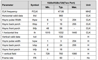

At present, when we are debugging the screen, there may be slight shaking when the screen is lit up, and this shaking will gradually decrease over time and disappear after about 3 minutes. This shaking is very slight, and the video taken by the phone is not very clear.
Please help confirm if my timing configuration is correct. Here is the timing in the screen length specification sheet.
This is the timing configuration in my code, both of which can cause screen shaking. Our 941 hardware design features a single DSI input and dual outputs.
If there are no issues, please help provide troubleshooting ideas
