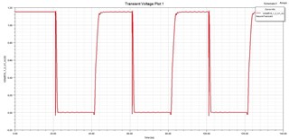

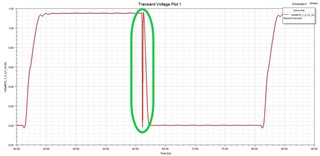

When IBIS model is performed by SIwave Ansys, we found there is a glitch waveform during turned off.
Here is wiring on the IBIS model with 50 Ohm.

Hi Brian,
Could you provide some more detail about this waveform? Is this from one of the RX_Data pins? This issue is only seen during power down?
Alvaro

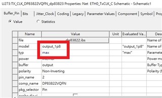

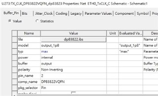

This behavior is happened at power down, and the output_1P8 max is selected on IBIS model.
Hi Brian,
Which pin is this output coming from? I ask because our IBIS files do NOT support simulation on the MDI side, i.e. the TD/RD pins.
Based off the 1p8 voltage level I'm assuming this is a RX_Data pin, please allow me another day to investigate. Apologies for the delay
