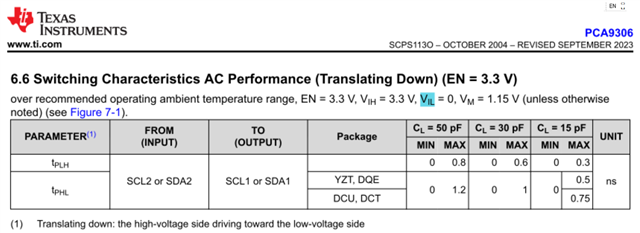

Dear Team,
Could you guide me what is VIL means?
Many Thanks,
Jimmy
  • Hi Jimmy,
    VIL = low-level input voltage.
    In this case for testing the switching characteristics, a low-level input voltage of 0V will be applied. In I2C, this VIL could range from 0V to 30% of VCC. Technically for EN = 3.3V, a VIL of 0.99 V would also be acceptable.
