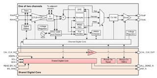

3) I understand that the HW reset in (1) initializes register settings and all circuits in the device, and the SW reset in (2) initializes only circuits related to CDRs. Where in the internal block diagram are the circuits that are not initialized by the SW reset but are initialized by the HW reset?

    (Q3) I understand that the HW reset in (1) initializes register settings and all circuits in the device, and the SW reset in (2) initializes only circuits related to CDRs. Where in the internal block diagram are the circuits that are not initialized by the SW reset but are initialized by the HW reset?
    (A3) It is challenging to give a clear divide between which functional blocks are and are not impacted by CDR reset without defining some additional criteria.  I would look at CDR reset as a state machine reset, while the hardware reset involves state machine resets and register configuration resets.
    Looking at the device block diagram, the CDR reset has no impact on the register configuration of any of the function blocks.  For example, the CDR reset will not change which adapt mode the receiver is using, and will not impact TX FIR settings.
    However, the CDR reset has a direct impact on the state of many functional blocks in the retimer.  CDR reset will cause the CDR functional block to re-acquire CDR lock.  As the retimer re-acquires CDR lock, it will re-adapt the RX settings.  This means that CDR reset has an impact on CTLE and DFE functional blocks.  Additionally, the retimer output will be muted until CDR lock is acquired, so the TX driver will not be in use until CDR lock is acquired.
