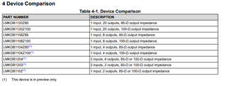

Is the SN65LVCP402 suitable for PCIe Gen5 clock buffer/MUX? If not, do you have any other recommendations?

I believe this could be suitable. However, I'm re-assigning to the product line handling clock buffers to give better insight on a component that offers buffer and MUX functionality.

We have a few options for PCIe Gen 5 clocking with MUX capabilities. My recommendation would be the LMKDB12xx series of buffers which are currently in preview only but expected to release shortly.
We also have offer the LMK0033x buffers which have 2 inputs and 4 or 8 outputs.

Great. Samples are available now, and RTM will be ~ July 2024.
