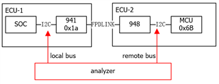

    MCU( 0x6B ) is setup as  ( 0x6D ) in 941 alias registers, SOC access MCU always use 0x6D as its address.
    when issue occor, the i2c command is to read 16 bytes from 0x10 register in MCU. so it's 2 i2c messages, one for write register value, one for read data.

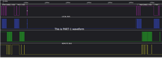

    1st write message success issued.   2nd message failed, but 1st byte is read out.  analyzer result is

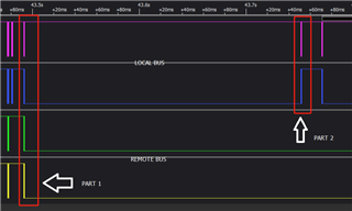

    the primary waveform is

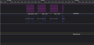

    and the defail waveform of part-1 and part-2 is

    Thank you for providing the initial information this issue. Is the MCU the only peripheral connected to the 948's I2C bus?
    On the remote bus, either the 948 or the MCU Is pulling the bus low. Specifically the SDA line never returns to the default state after the setup write. On the local bus, there is clock stretching on the SCL line which is expected and the SDA line goes high during this time. There is a watchdog timer on the 948 that will clear the bus if SDA is pulled low. Register 0x6 (I2C_CONTROL_2) can be set to 0x3 to enable the watchdog timer. It will clear the bus after 50µs.

        Thanks for your reply.  ECU-2 is from other company, we don't know the detail of inside. as I know , the mcu is the controller of ECU-2, other sensors is accessed  directly by mcu, SOC communicate with mcu to access sensors indirectly.

    I was able to look at the I2C waveform. Here is the main issue I see (starting at 43.492s).
    The SoC initiates the 16-byte read from the MCU and we are able to get one byte from the MCU. During the readback, the MCU is driving the SDA and SCL lanes on the remote side. After that first byte, the MCU only pulses the clock once then stops. This is strange since the previous 16-byte transaction at 43.4766s is the exact same read but the MCU drives the SCL lane correctly.
