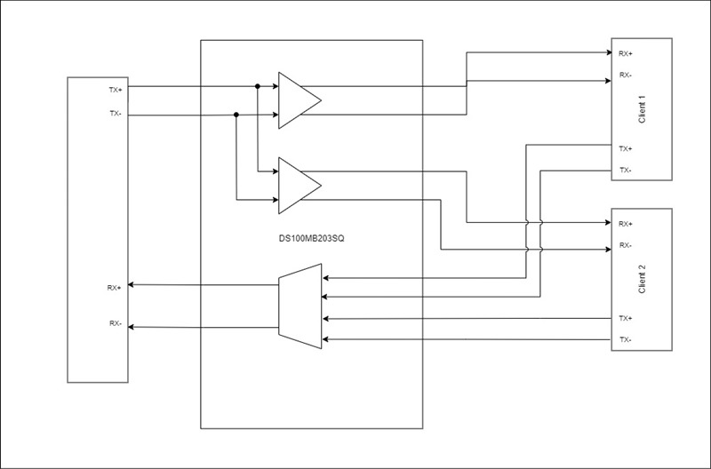

Part Number: DS100MB203
In our application we have to split a 10G ethernet connection(we are choosing about 10Gbase-KR or 10Gbase-R) from one port to two clients.
We exploring possibility to use DS100MB203SQ for this purpose. In particular use fanout buffer side to split TX (sender side) and use mux for RX(sender side) like picture below.
Since only one clients at time have both tx/rx connected, is it possible that both client are able to receive data or not?
With KR I'm worried about autonegotiation feature and link training. Maybe is it better with 10Gbase-R?
Thank you for your help
