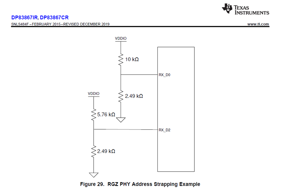

DP83867IR: Question on Figure 29 in February 2015 datasheet (SNLS484F)
Part Number: DP83867IR
When using the RGX package, can you explain how figure 29 gives a PHY address of 0b1001?   In that figure, shouldn't RX_D3 be tied asserted high instead of RX_D2, and RX_D1 and RX_D2 grounded?   I'm trying to figure out how the PHY_ADD0-PHY_ADD3 correspond to the strapping in Table 5.   During 'strapping time', doesn't PHY_ADD0-3 correspond to the strapping of RX_D0-3?
