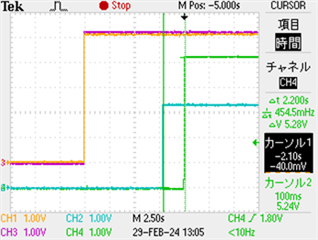

Hi team,
When I changed the device operating mode from Client to normal mode by
setting INT1 pin Low --> High (ILIM SEL=Low), then VBUS switch turn on non monotonic.

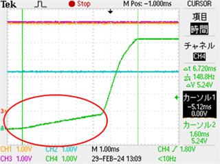

VBUS ramp up slowly till 1V in 5ms and then ramp up to 5V in 1ms to 2ms.
5V is already applied to IN pin and EN pin, then change INT 1 level from Low to High.
VBUS pin is initial Low.
Could you please explain why VBUS ramp up straight to 5V?
Please see below in red circle. left image is horizontal zoom image of right image.
