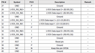

Dear Team,
May I know the Horizontal Sync and Vertical Sync pins of DS90UB928Q-Q1.
I need to connect it to my LVDS.
The LCD has dedicated Horizontal Sync and Vertical Sync pins.
Can I use any GPIO for HS and VS signals

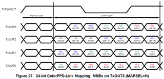

Hello Hari,
I believe either the UB928 or the UB948 are the right parts for you (Based on your PCLK).
Normally HS and VS come integrated in the LVDS signal Data-Lane 2, as you can see below (from UB928 d/s). You shall be using the 24-bits MAPSEL = H mode.
