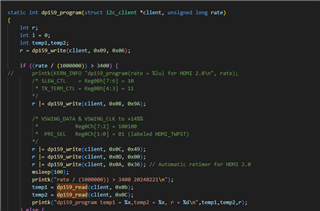

The [1:0] bits of the 0x0C register seem uncontrollable. In the program, these two bits are written to 01 and read as 00
It is already in IIC mode, and the HDMI signal is normal

    This is the dp159 driver code,
    dp159_write(client, 0x0C, 0x49);
    but
    dp159_read
    (client, 0x0C);
    value is 0x48;

  • Are you able to use an external I2C controller other than the driver to read and write to the registers?
  • Unfortunately, we do not support software, so I will not be able to help you debug your driver code.

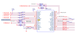

  • Hey, It seems that you need to have a valid clock at the IN_CLK pins to change these register values. It was just verified in lab.
  • Hey,are this the IN_CLK pins?
    The HDMI signal is normal, what do you mean by valid clock?
  • The HDMI signal is normal, what do you mean by valid clock?
    A valid clock meaning that you need to have HDMI traffic running through the device to change the values of the [1:0] bits of the 0x0C register
