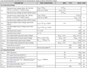

Transmitter Supply Current in [mA] (Test Condition : IDCK= 165 MHz, 1-pixel/clock mode, REXT_SWING = 510Ω, Worst Case Pattern)
Measurement taken at VCC = 3.30V.
Measurement taken at VCC = 3.60V.
Part Number: TFP410
Hi, The test conditions is matching but, I want to know the measurements taken @ which VCC values?
Foe example Vcc=3.3 @ Tyo value and Vcc=3.6 for max.
Chaithra KM
Hey Chaithra,
I'm looking into this, however it may take some time as this is an older part.
The max current of 250mA was taken at the maximum voltage of 3.6.
The typical value data was unfortunately not taken.

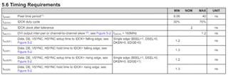

Hi Vishesh,
Thank you for the information. I need much more information for the MPN: TFP410PAP.
Chaithra KM
Hey Chaitra,
Please have a look at the datasheet you will find most of what you're looking for under section 5.
HI Vishesh
The requested information is not available in datasheet. Therefore, we need the below Information ASAP.
Chaithra KM
In the future please look at the datasheet.
Hi Vishesh,
Sorry for the inconvenience. Kindly share the latest datasheet. There is some mismatches in datasheet we are referring.
Chaithra KM
