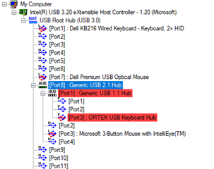

    On Windows machine we did the test manually and observed the device connection state with USB Device Tree Viewer V3.8.1.
    Looks like you have used the same software.
    Manually plugging and unplugging a mouse was able to cause the TUS4041I to disconnect. At the same time you lose all USB devices connected to the TUSB4041I. In our case there was a USB keyboard connected as well.
    This happens only once - the TUSB4041I disconnect and re-enumerate right back and the connected USB devices re-enumerate as well.

  • One thing I noticed that was interesting on USB Tree View is that the text on the port changes from "Generic USB 2.1 Hub" to "Generic USB 2.0 Hub" after the failure.  Is it the same in your case?
    Nicholaus
