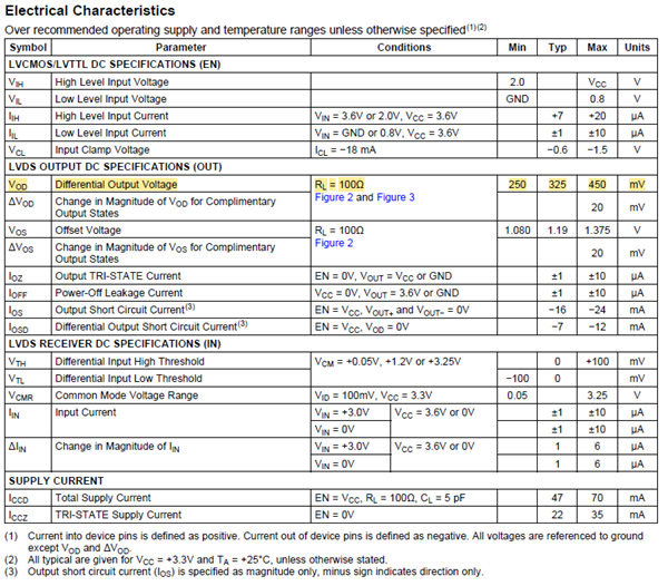

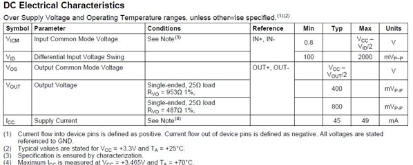

The signal detect feature is not used, DP83869HM SD pin is active low (grounded) to show always valid signal.

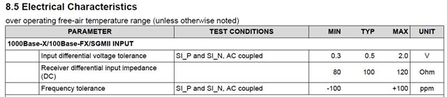

We observed that once we reduce received optical power on both units with DP83869HM, the synchronization and communication come back.
  1. Could you please explain whether there is some built in logic which the DP83869HMs may influence each other in this configuration?
  2. What could create increased optical power to the DP83869HM? (RX signals are LVDS)
