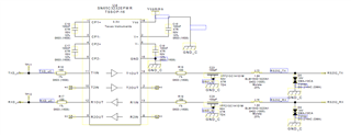

  • Hi Thusith,
    Can you provide a schematic for us to review?
    Can you show us the scopeshots of the issue you are seeing?
    Can you also probe the V-/V+ pins of the device and make sure they aren't drooping/collapsing?
    -Bobby
  • Hi Bobby
    Sorry for late reply!
    Please find schematic diagram below.
    TXD_uC is connected to UART_Tx of STM32 microcontroller. The waveform is measured at RS232_TX.
    Vcomms is at +3.3V
    Garbage value reception and associated wave forms are demonstrated in below video.

  • Pin 11 is a digital input; you must not try to apply analog voltages to it. The output is defined only for valid logic levels, i.e., for voltages near 0 V and 3.3 V.
    Pin 10 must not be left floating.
    This device already handles the RS-232 bus voltages/currents; remove R18 and R19. (But this is not related to this problem.)
    Please show an oscilloscope trace with both pin 11 and pin 14, with a valid UART input signal.

  • Hi Thusith,
    I agree with Clemen's comments.
    Pin10 (Tin2) should not be floating.
    The output waveform in your first video looks like it is swinging to both rails properly without collapsing so I don't necessarily think it's related to the switching caps just yet.
    I do think we should look at this with two probes on the o-scope. One on the TTL input side (TXD_U) and one of the cable output (RS232_TX). We want to verify the input isn't inputting noise which gets picked up and sent on the output.
    When the mcu isn't driving the TXD_U net, is there any kind of pull up resistor on the net to ensure its stays at a 5V logic? Or are you sure the MCU is actively holding the TXD_U net high when it's idle?
    Other comments:
    Do you have any decoupling caps on the Vcc pin for our device?
    On a routing perspective, is there any high frequency or high current switching happening under the T1IN/T1OUT traces?
    -Bobby

  • The schematic is incomplete. Please show everything that is connected to the TXD_uC line. Also tell us how the microcontroller's output pin is configured (low, high, or Hi-Z) when the UART output is idle. (I suspect that the line is floating. In that case, a pull-up resistor would help.)
  • Hi Thusith,
    surprisingly after connecting oscilloscope probe with TxD_uC (pin-11) abnormal behavior disappeared. no spikey waveform on oscilloscope. no garbage on terminal window. at the end still waveform can be observed.
    This seems to indicate that this may likely be due to noise or something coupling onto the input pin (TXD_uc) and the mcu isn't holding the output to this net (I suspect it's high-z or a very weak pull down. In most set ups I see, this pin is held HIGH and usually has a weak pull up resistor to hold it high until the MCU is powered and ready to actively drive the pin.
    I think you may want to try putting a 10k or 4.7k pull up resistor on the pin and rerun your testing to see if you still see the issue. Adding a small 100pF cap on the pin can also help filter out any noise that appears on the pin.
    As for why you see one device seeing the issue and not the other, I suspect has to do with silicon variations (doping levels) due to different fab sites and lots.
    -Bobby
