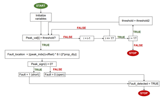

I'm currently in the process of updating the DP83867 driver to incorporate Time Domain Reflectometry (TDR) functionality. However, I've encountered an issue during testing. Regardless of how many times I run the test using 'ethtool --cable-test eno1', the results retrieved from the registers remain consistent, even after trying different cables.
Here's a snippet of the code I'm working with:
ret = phy_read(phydev, DP83867_TDR_PEAKS_LOC_8);
	if(ret < 0)
		return ret;
	printk("DP83867_TDR_PEAKS_LOC_8: %d", ret);
	matrix[0][0] = (ret & DP83867_TDR_PEAKS_LOC_8_D_0_MASK) >> DP83867_TDR_PEAKS_LOC_8_D_0_SHIFT;
	ret = phy_read(phydev, DP83867_TDR_PEAKS_LOC_9);
	if (ret < 0)
		return ret;
	printk("DP83867_TDR_PEAKS_LOC_9: %d", ret);
	matrix[1][0] = ret & DP83867_TDR_PEAKS_LOC_9_D_1_MASK;
	matrix[2][0] = (ret & DP83867_TDR_PEAKS_LOC_9_D_2_MASK) >> DP83867_TDR_PEAKS_LOC_9_D_2_SHIFT;
	ret = phy_read(phydev, DP83867_TDR_PEAKS_LOC_10);
	if (ret < 0)
		return ret;
Any insights or suggestions on resolving this issue would be greatly appreciated. Thank you in advance for your help.
kind regards,
Mart

  • Hi Evan,
    Thanks for your responses
    I added some print statements to the driver, here is a screenshot of the results. Everytime I rerun the test i get the same values from the registers. I already tried different cables but these give the same results.
  • Hi Mart,
    Is the phy_read() function able to access registers in extended MMD space?
    If not, you will need to incorporate or find a function that performs extended register procedure shown in this FAQ in order to access TDR registers (Read (No Post Increment) Operation).
    I recommend validating this function by reading any register past address 0x32 and confirming the default value is returned.
    Thank you,
    Evan
