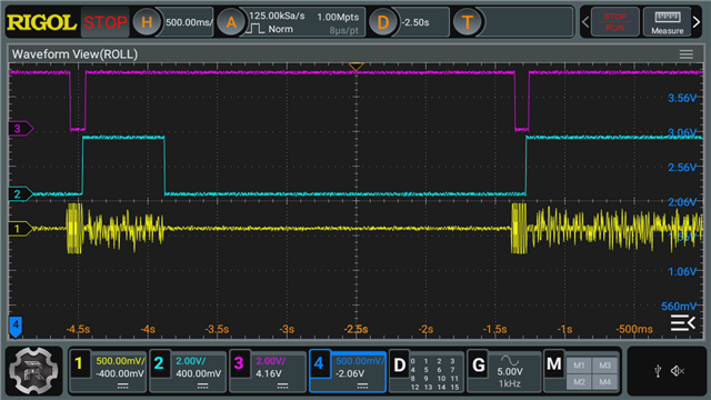

The problem looks as follows. When our TUSB8020B hub is connected to the PC, it is correctly recognized (as USB 2.0 and USB 3.0 devices) and appears in USB TreeView as expected. Then, when our device is connected to the hub and powered up, its both controllers (independent Super Speed Cypress FX3 and Full Speed FTDI FT230X) are also correctly recognized, but shortly after, the Super Speed device cyclically disappears from the system and then reappears with a period of a few seconds, which can be seen in USB TreeView (and heard as standard "ding-dong dong-ding ding-dong" from the system). The Full Speed controller remains properly connected.

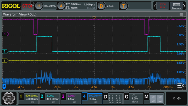

We have captured the waveforms on SS_DNx (purple/3), SS_UP (cyan/2), SSTXx_UP (blue/4) and SSRXx_UP (yellow/1) pins of TUSB8020B. Unfortunately, we do not have access to an USB 3 protocol analyzer. We were also unable to capture SSRX and SSTX at the same time for an interesting reason: with two oscilloscope probes (10 MOhm ~3 pF) touching an SSRX and an SSTX line simultaneously (no matter P or M), the link instability disappeared!
The following pattern repeats: SS_UP goes high and SS_DNx goes high as well. After 300 to 2000 milliseconds (the time varies widely) SS_UP goes low, SS_DN remains high for about 2.5 seconds, then goes low (for about 100 milliseconds). While SS_UP is low, the waveform on SSTXx_UP looks like link negotiation.

We underscore that our design worked properly with Intel NUC PCs for a couple of years. We have Super Speed transmission lines in our boards on both sides of TUSB8020B (approx. 10 cm in length), the lines are carefully laid out and our PCBs are manufactured with impedance control for symmetric lines. We have board revisions from two manufacturers and both experience similar problems (the older revision seems to lose the link less frequently, however).
We know that NUC mainboards are small and therefore they have relatively short Super Speed transmission lines, and this is also the case with the add-on PCIe card, while normal PC motherboards are much bigger and often have much longer transmission lines. We have seen complaints on unreliable USB 3 ports in various mainboards. Our most tested mainboard has signal redrivers in the transission lines, and we have seen complaints on redriver-equipped ports as well. We also know from our own experience that Cypress FX3 performs poorly with redrivers in the transmission lines (but here we have TUSB8020B in the middle).
We suspect that the problem is poor quality of the link between the hub and the host on the PC MB, not necessarily on our side (worked perfectly with NUC), maybe due to a very large distance between the sockets and the MB chipset.
- Why then the problem only occurs only with our device on the downlink side of TUSB8020B? We have tried other devices: hard disks, video grabbers -- none experienced similar problems.
- When our device is connected directly to the same MB port, it works properly (no link loss). Why adding a hub in between induces the problem?
- Can this be related to the short Pending HP Timer of TUSB8020B?
We would be grateful for any suggestions and help with interpreting the oscilloscope waveforms.

  • We know that an analyzer would be the best solution, but we don't have one yet.
    We are not sure that sending this particular motherboard will help anything. On the other test board (different manufacturer and chipset, same generation of processors) the same problems occur, only with slightly less intensity. In fact, one only has to browse the Internet to find an absurdly large number of posts on discussion forums related to the malfunctioning of USB3 ports on most new motherboards. Apparently, someone has exaggerated the technology and it has become unreliable.
    To sum up - the problem does not apply only to this motherboard, but rather to a greater or lesser extent to all new motherboards. We would just like to know its genesis. We can temporarily or permanently solve the problem by using an expansion card, but we would prefer to know the more precise reason for the current malfunction. The device of which the TUSB8020b is a part is a medical device and this is important to us.

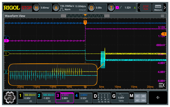

       For Q2: It's hard to get link information from  your waveform. Can you zoom the SSTX and SSRX waveform, SSRX seems get LFPS signal and followed by  polling signal, then go to idle , but SSTX just keep sending data signal.

    Here are the zoomed waveforms:

  • Hi Brian,
    We were in a bit of a hurry last time and didn't send the waveforms in the right order.
    The colors of the waveforms indicate the same signals as in the first series of waveforms.
    The first image is a general overview of the whole reconnection cycle, the second is the zoomed moment of loss of the SuperSpeed link on the host side, the third and fourth images are the zoomed moments of loss of the SuperSpeed link on the camera side (and then the moment of the reconnection). The two last images were doubled because it was difficult for us to get all four signals recorded together, and in the last one SSTXx_UP probe (blue) is also connected. In the first and third images, the probe is not connected to SSTXx_UP (just noise in the waveform).
    Michal

       For the yellow waveform,  it is  single ended or  differtial signal,? it seems around 800mv to 1000mv.
    Brian
  • Hi Brian,
    Yes, all signals are single ended with probe set as 10x (10 MOhm || 10 pF). We do not have a HF differential probe.

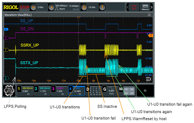

    Sorry for the delay in responding, we were doing a lot of tests and measurements.
    We carefully analyzed with an oscilloscope all the waveforms from the host side and from the device side with enough time resolution to be able to distinguish all types of LFPS signals.
    The first picture shows a general view of the 3 cycles of connecting and disconnecting of the device with our interpretation of the signals.
    In the next pictures, magnified fragments of the waveforms are shown. First comes the LFPS.Polling:
    It is followed by multiple U1-U0 transitions, which end at a random moment with a timeout and a transition to SS.Inactive shown in the next picture.
    We have verified experimentally that while RX.Detect, the HUB tests the receiver connection every 20 ms. In the picture above, the gaps are about 12 ms, which clearly points at SS.Inactive. The HUB can only exit SS.Inactive via physical disconnection of the link or via WarmReset. The Host sends WarmReset after a 2-second timeout as shown below in a magnified picture.
    There is just one failed (probably timed out) attempt to transit from U1 to U0, marked with a red exclamation mark in the graph below. All other operations visible in the waveforms are correct and result either from the previous operations of from the error mentioned above.
    The time between the transition to SS.Inactive and the failed U1 to U0 transition is always between 4.5 ms and 6 ms, suggesting that either Ux_EXIT_TIMER or tRecoveryIdleTimeout is exceeded. Most likely, it is the HUB which is responsible for the disconnection, and it happens during Recovery.Active, Recovery.Configuration or Recovery.Idle. It is further supported by the fact that the error only occurs with the camera equipped with Cypress FX3. We have tested a lot of other devices – mass storage and frame grabbers – and the disconnection never happened. Our interpretation of the waveforms allows to attribute the disconnections to the unusual behavior of FX3, which repeatedly, in 1 ms periods, switches between U1 and U0, which is not disallowed, but forces frequent Recovery states. When we have disabled the support for U1/U2 in the HUB (register 5 bit 5, u1u2Disable), the errors disappeared because of the lack of Recovery after U1 to U0 transition.
    This configuration change eliminates the problem but does not fix its root cause which remains unknown. In a medical device, we need to know the origin of the problem. It would be the simplest to attribute the problem to a poor signal quality in the SSRX_UP lines, but...:
    1. After disabling U1/U2 support in the HUB, i.e., with link disconnection eliminated, we performed long hours of data transmission stability tests – the camera sent over 50 million frames at 3200 frames per second without any problems.
    2. We have found an early prototype of our hub PCB, which had the USB SS traces less carefully laid out and had a different type of socket at the Host side (A-type, now we have Micro-B-type). This board does not exhibit the problem with link disconnection with any host, and perfectly tolerates the frequent transitions between U0 and U1.
    It is then hard to believe that the signal quality is poor when we can transfer huge amounts of data without any problems, and a similar (but less carefully designed) board with similar length of USB SS traces does not exhibit the issue.
    We would like to ask whether out interpretation of the waveforms is correct and we will be very grateful for any suggestions on what can be the problem during Recovery.

  • Hi Michal:
       Thanks for your detailed information to debug the issue:
    1: if the downstream port device only support u1, then it will not go into U2.
    2: I saw it before , RX detect signal is positive pulse, But I will confirm again in our lab.
    3: In U1 u2, TX common mode voltage should not be change much.
       We saw another u1u2 issue recently which can be solved by u1u2 disable as well. Can you try with  09h:20 and 05h:12 which change u1u1 timeout ?
