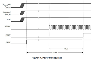

Hi Team,
Please tell me about the XIO2001.
In our design, Voltage from the PCI Device A leaks into the PCI pin while Power-on.
Is the following waveform acceptable?
Kitagawa

Hi Nasser,
Thank you for your reply.
Does that mean that the inside of the PCI pin does not damaged while PERST# is asserted.
Kitagwa
Hi Kitagawa-San,
Your understanding is correct. During PERST# there could be transitions on supply and reference clock. We do not expect to cause part damage. Also, there has not been a report of this as well.
