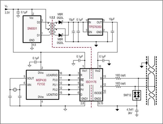

I need a external protection 5KV for ISO1176 , I have been trying to use TVS SACB 8.5, but using this device I have had problems to increase the speeds above 1,5 MB/s because of the device's capacitance.

please try SM712 from Bourns (see attached data sheet).
