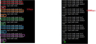

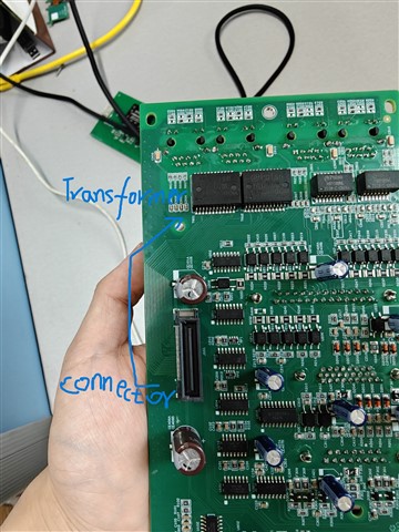

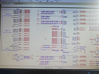

My customer are using DP83867 in their CNC platform. They are debugging the device with 100M Cable. They have successfully connected the Cable with DP83867 on their test board. But, when they tested on their CNC board, it went wrong. Here are the register values before and after connecting the cable. I have found some difference between Reg 0x0005/0x0006/0x0008/0x0011/0x0013. More detailed register values are attached in excel.
Could you advise what i need to do next to posit the root cause and fix it?
CNC did not connect Cable (100M) CNC connect Cable (100M) Test board did not connect to Cable (100M) Test board connect to Cable (100M)
addr=00 reg=05 data=0000 addr=00 reg=05 data=CD81 addr=00 reg=05 data=0000 addr=00 reg=05 data=CD81
addr=00 reg=06 data=0066 addr=00 reg=06 data=006F addr=00 reg=06 data=0064 addr=00 reg=06 data=006F
addr=00 reg=08 data=0000 addr=00 reg=08 data=E00A addr=00 reg=08 data=0000 addr=00 reg=08 data=6001
addr=00 reg=11 data=1302 addr=00 reg=11 data=1002 addr=00 reg=11 data=0002 addr=00 reg=11 data=7F02
addr=00 reg=13 data=1C40 addr=00 reg=13 data=9042 addr=00 reg=13 data=0040 addr=00 reg=13 data=1C40
