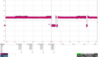

  • Hello Ikram,
    I have done the test again with a probe directly on the LOCK.
    With the probe of lock pin with an oscilloscope, we have this behavior :
    The RIN+ signal is continuously connected to the GND.
    We can see that the Pin Lock is not permanently down, I think it's why the software can't read exactly the right value of the LOCK.
    The signal Lock is directly connected to the MCU on the schematic.
    The Read is done from the DESER part and not by the USB of the Evalboard SER.
    Is it a normal behavior from the component ?
    Camille HUYNH

  • Hi Camille,
    Lock is dropping occasionally indicating the serial link fault. If you have a differential (STP) connection, then the deserializer might be recovering PLL lock, and that's why LOCK is not low throughout.
    You could consider having the LOCK connection to SoC as an interrupt so it can be detected.
    Also, could you please check the 929 0x0C General Status register Link Detect and Link Lost bits. The Link Lost flag and CRC Errors (0xA and 0xB) can be used to detect when the link is lost due to the fault.

  • Hi Camille,
    We tested this and we found that you can use the 929 Link Lost register 0xC[4] flag to detect any momentary loss of LOCK/ Link.
    1. When there is a continuous LOCK drop (such as an OPEN cable), the LOCK pin, and 0x1C register on 928 can be used to detect the fault. Also, there will be a loss of I2C communication to the SER
    2. When there is a momentary loss of LOCK: after enabling I2C passthrough (so the deserializer-side MCU can read the SER and DES), you can read the SER 0x1C[4] flag to detect that there was a momentary loss of lock.
    Please let us know if this solves the issue for your case.
