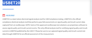

  • For full speed 12Mbps, PCB trace may not make much difference. can you take full speed package waveform with single ended probe and upload waveform to USBET20 tool to check FS eye diagram?
      You can get USBET20  from USB.org

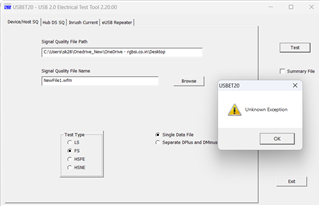

  • Hi Brian, I captured USB differential lines using single ended probes but I'm facing an error while uploading the file to USBET20 tool-> "Unknown Exception".
    If you know any workaround then let me know I'll capture the waveform with short ground length for better waveform & upload here.
    Or do you know any parameters(Rise time, setup & hole time etc) through which we can analyse in the oscilloscope itself?
    I'm attaching the .wfm file as well so that you can also try once

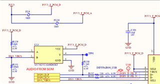

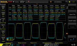

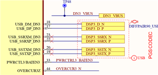

  • While analysing the waveform, I noticed that the common mode & differential mode voltage won't comply to the USB2.0 specs due to pull-up resistor on the DP line.
    The PCM2903CDB has recommended a pull-up resistor on the DP line with a AND gate(1st image). Our implementation(2nd at TUSB8041 & 3rd at PCM2903CDB) image which is having yellow in symbols)
    As per specs, we should have common mode voltage of 0.8 to 2.5V( but we're getting more than 3V i.e., (3.37+3.19)/2=3.28V) & differential mode voltage of about 400mV as per my observation on various waveform but ours is 5V!
    I couldn't able to see much info on pull-up resistor importance( Only before POR, it's used for detecting the downstream ports). If it's internal with a switch then it could do but we're providing an external pull-up so will it cause any issues?
  • Did you pullup DP with 1.5k to 3.3v?
    From the waveform , it looks like clock signal, not looks like full speed package.
    Regarding USB20 tool, I will check next Monday to see which format to save.

  • Hi Santhosh:
       For USBET20 tool, please take waveform with CSV format, then load *CSV file to USBET20 tool.
       USB_R1 will affect the drive current on DP/DM which affect the driver strength at USB2.0 speeds.
