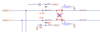

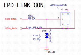

Our products use 949 and 948. At present, the clock pin of 948 is low, the port 0 is used in 949, and the line is coaxial single-ended with a length of 2.5 meters. The schematic diagram is as follows
948:
949:

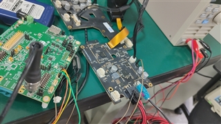

The board connection is shown
May I ask why the clock signal is low and how to troubleshoot the problem? Thank you!
Thanks for including the photo of your setup. I cannot discuss the parts you are working with on the public forum. Please contact your local TI representative for further assistance.
