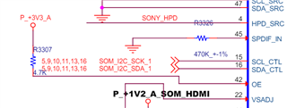

2. Please help to review the schematic and share your feedback if any risk.
TMS181.pdf

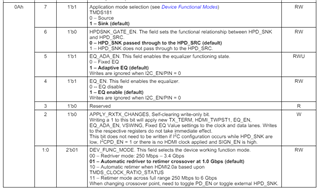

  • 1. Can we manual control TMDS181 operate in bypass mode (as redriver)? no matter the data rate.
    If yes, how to set the mode?
    This can be set at register 0x0A

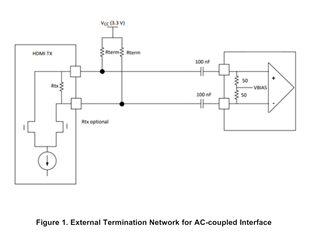

    1) Need to have either SNK or SRC connected for DDC snooping
    2) Need this implementation for AC coupled output:
    3) Missing 0.2nF capacitor to slow down OE timing:
    4) Im not sure where the following signal are from:
    - SOM_SONY_HPD
    - SOM_I2C_SCK_1
    - SOM_I2C_SDA_1

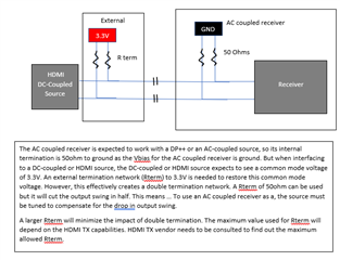

    1. In Figure1 in previous discussion(external termination). If we set TX_TERM_CTL=L, did we still need to add external pull-up Rterm?

  • 1. In Figure1 in previous discussion(external termination). If we set TX_TERM_CTL=L, did we still need to add external pull-up Rterm?
    Yes, this external pull up is still needed. The TX_TERM_CTL is differentially terminated and does not got to 3.3V. The external pull ups are required for TMDS181 to be recognized as a HDMI source with AC couplings.

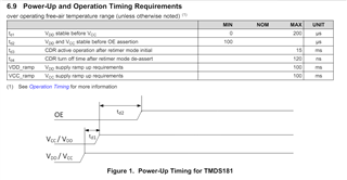

    2. What is the risk if power on sequence not meet datasheet "td1"(VDD stable before VCC)?  In customer's current design, it's hard to modify power on sequence.
    If the power on sequence is not met, then we cannot guarantee proper device performance. The following parameters must be followed:
    By the looks of it it seems that the there are multiple issue with the system so I cannot say where the issue is originating from. Try changing the issue mentioned in the schematic and layout and see if the device spec can be met.
