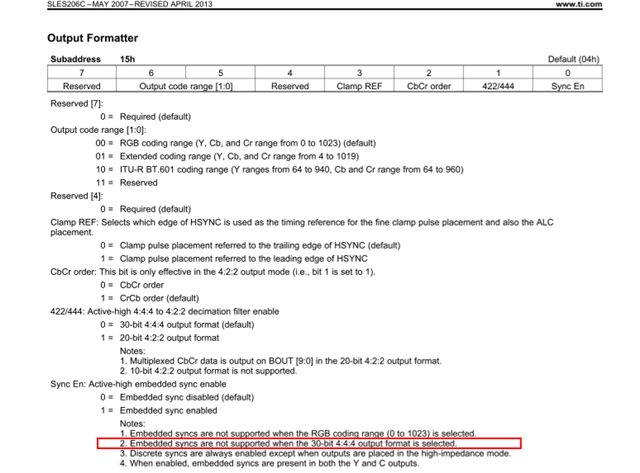

TVP7002: Embedded synchronization mode problem
Part Number: TVP7002
Dears,
As shown in the figure below, the description of embedded synchronization signals in the data manual is not supported when it is 30 bits.I would like to inquire if embedded data is supported for Yuv444 format data with 24 bit and below? At present, when we test the output format of 24Bit, the output image is incorrect. Please help us see how to output it correctly. Looking forward to your reply. Thank you~
